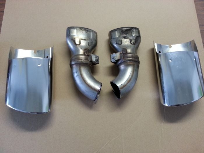

You may choose to remove or not to remove the original exhaust tips at this point (its up to you because you are going to cut the tail pipes back to 40mm))

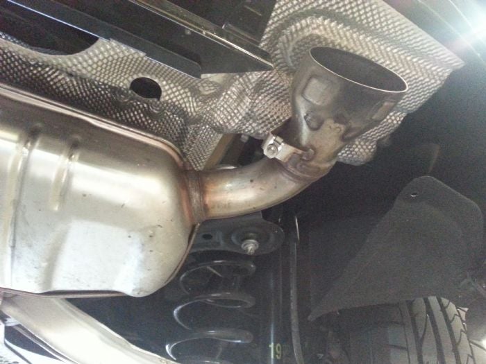

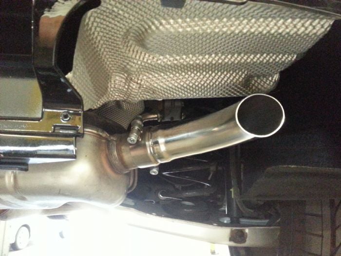

Above is to show you why it is NOT " plug and play". The original tail pipes are not wide enough for the A45 diffuser.
Measure 40mm from the muffler and cut. (with a pipe cutter or saw)
</span>

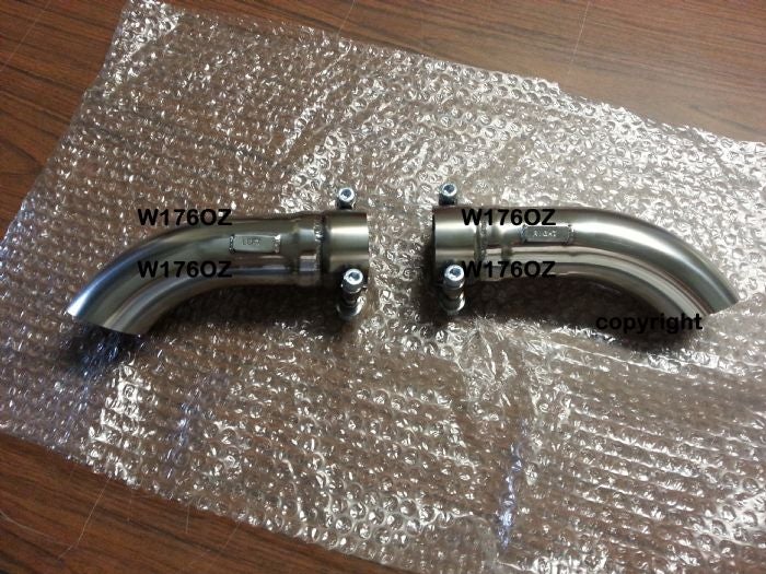

Now, put on the tail pipe extensions. Only slightly tighten it so you can adjust it when the diffuser and exhaust tips are fitted.</span>

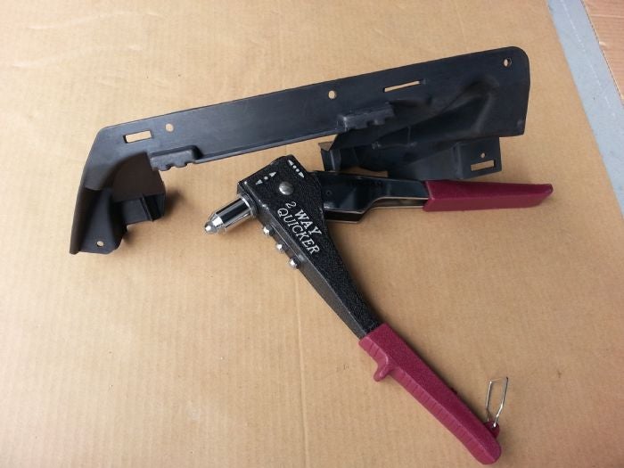

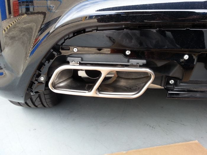

Install brackets to the bumper bar with pot rivets. The brackets are for the exhaust tips to attach to.

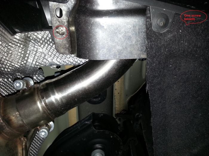

Two screws are required to secure the exhaust tips. See below. ( You can now align and tighten the tail pipe extensions).

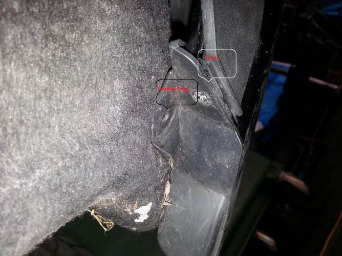

Clip in the A45 diffuser and secure each lower corner of the diffuser with pot rivet and reinsert black plastic plugs. (Refer to how to remove diffuser)
