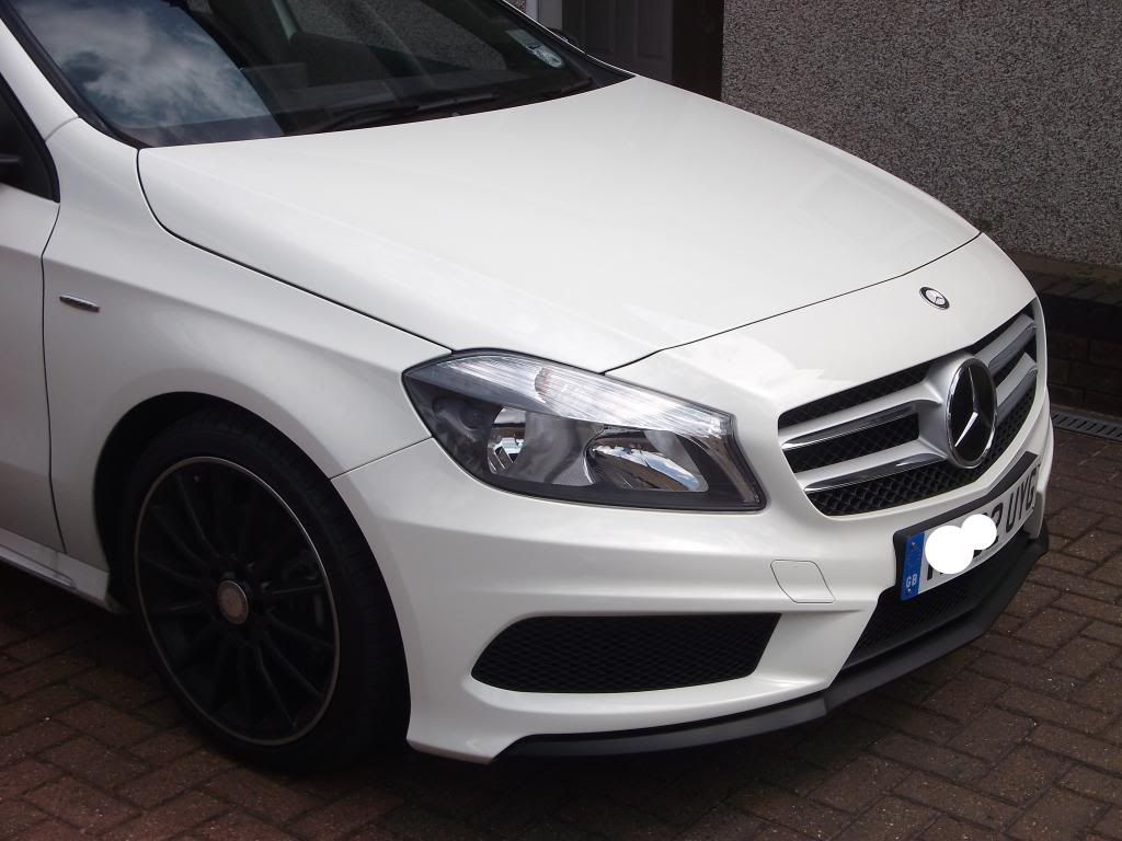

Here's the how to:
1. Purchased 400ml plastidip black spray can from http://www.plastidip.co.uk/index.cfm
2. Learned how to work with the stuff from the Plastidip guru Fonz: http://www.youtube.com/user/DipYourCarcom
3. Masked around the bumper and grill area: See pics as follows:
4. Make sure you get the masking tapereally close to the edges of the splitter:
5. For tips on how to do the spraying follow the Fonz's videos. Iwaited 12 to 15 minutes between coats, and did 5 coats in total........picture between coats:
6. Be careful when removing masking tape, as plastidip is quite tacky when drying, so you need remove carefully, particularly in the "cranny" where the top of the splitter meets the bottom of the bumper. I actually used a thin screwdriver head to score along the join lines first.

Nice, I've had that in mind for a couple of weeks. Have you thought of doing the inside of the skirts too?

Platidip is the nuts. I've had a can here since I ordered my A - ready to black the rear badges as soon as she arrives!!
In the mean time I have been using my dads car as practice
Looks awesome on your front lip!

Hi Dan, yes I have thought about the inside of the skirts, but on the bottom side, there is no obvious gap, unlike on the top sideand so I'm not sure how I will peel away the excessplastidip once it dries. Any ideas ?
Most of the you tube vids advise you to use an obvious gap to peel away the excess once dried, i.e. like the gap on a door. I may have to ask the guru Fonz on how togo aboutit.
For now, I'll see how I get on with the front splitter.

You could run a line of very fine masking tape to create a cut edge? I'm going to order a couple of cans to try some bits.

Not sure that would work, as when you go to pull the masking tape, the plastidip will all pull away in one piece, which is why you need the break-line. Not sure if that makes sense............try it out as you say, and let me know how you get on.

i was thinking of using 1mm pin striping tape to make a break line

Dan, try it and let us know how you get on; I think you'll still have trouble removing exactly along the break line that you make with the tape, as the plastidip will stretch and tear......i.e. tear, and not necessarily along the break line you made. I could be wrong.
