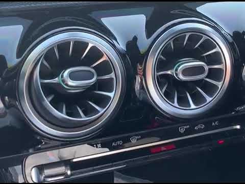

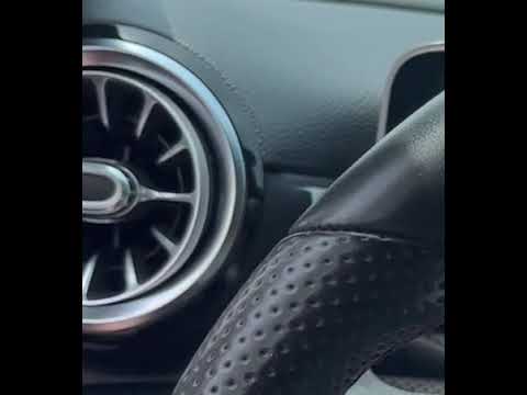

Below are videos/audios of the various noises I've managed to record (except the infamous B pillar rattle):
1. The aforementioned steering wheel creaking / grinding noise (turn up the volume to hear, hopefully this is what you're referring to).
2. Overhead control unit fan noise. Dealer's solution: replace the unit for £210 + labour £45.
3. Central panel (wireless charging area) fan noise. Kicks in when the car interior is warm. Dealer: replace the NFC control unit for £760 + labour £175.
4. AC grinding noise when changing airflow direction. Dealer: AC motor may be faulty, labour £295 to remove the panelling just to inspect.
5. Bonus: low groaning noise when turning at low speeds. Disappeared for a while then came back but only at very low speeds. Taking it later this month to inspect. Anyone got a clue? Google says wheel bearings that are starting to wear out / CV joint losing lubrication.
Verdict: only the steering noises bother me enough to pay for a fix. The rest I can unhappily live with until I get rid of the car. Will not be getting another MB unless the manufacturer's warranty here matches that of the other German brands (5 years) and the dealer improves their extended warranty.
