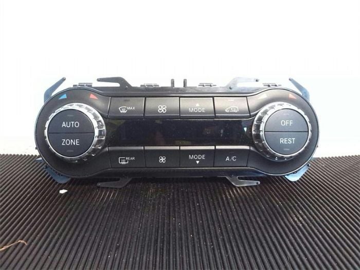

Hello, I have a question, the difference between the air conditioner and the automatic air conditioner is the connector that I have marked, that connector has twelve pins, I think there are connected several probes, someone could say which, thanks

Ok. I have modified to climatronic and ist works very well.You need a climate-control (A2469008415), the temperature-sensor right of the steeringwheel (</span></font>A2118300272), Sun-Sensor (</span>A2049057501), a new roof-control-unit withtemperature-sensor(depends on themodel) and the micro-switch of the cable (</span></font>A2468200615). And a connecter like the part above (blog robunax).</span>Optional: NOX-Sensor (</span>A2045420918).</span>
But with this parts: No Rest-Heat and nopossibility to steering the air to left or right.</span></font>

MarcGLA said:
Ok. I have modified to climatronic and ist works very well.You need a climate-control (<span style="font-size: 12px;]A2469008415), the temperature-sensor right of the steering wheel (</span><span style="color: rgb16, 48, 80; font-family: Verdana, Helvetica, Arial, sans-serif; font-size: 12px;">A2118300272), Sun-Sensor (</span><span style="font-size: 12px;]A2049057501), a new roof-control-unit with temperature-sensor (depends on the model) and the micro-switch of the cable (</span><span style="color: rgb16, 48, 80; font-family: Verdana, Helvetica, Arial, sans-serif; font-size: 12px;">A2468200615). And a connecter like the part above (blog robunax). </span><span style="color: rgb16, 48, 80; font-family: Verdana, Helvetica, Arial, sans-serif; font-size: 12px;">Optional: NOX-Sensor (</span><span style="color: rgb16, 48, 80; font-family: Verdana, Helvetica, Arial, sans-serif; font-size: 12px;">A2045420918).</span>
<span style="font-size: 12px;]But with this parts: No Rest-Heat and no possibility to steering the air to left or right.</span>

Hi, one question, What does the micro switch do and where is it located?

The microswitch is on Pin 3 and 1 of the right connector (See picture of Control Panel above). The Switch determinate the Position of the central air distribution. Without the switch it""˜s a long search for the right vent.
