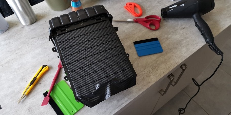

Middle draw section looks awesome mate, how difficult did you find it?

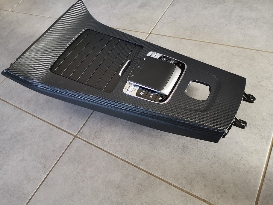

Awesome job mate looks fantastic 👌Finally got round to wrapping the centre console.

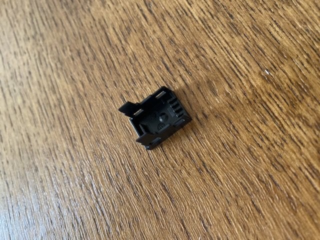

Followed Raymondooo’s advice and things went fairly well. The button that operates the lid of the arm rest was a bit tricky. You only have to push the screwdriver into the rectangular slot for about 1mm to release the back of the panel and then two small but long screwdrivers pushed in to the round holes completely straight and horizontal and the legs are released.

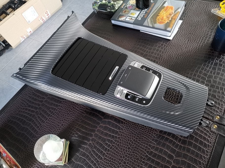

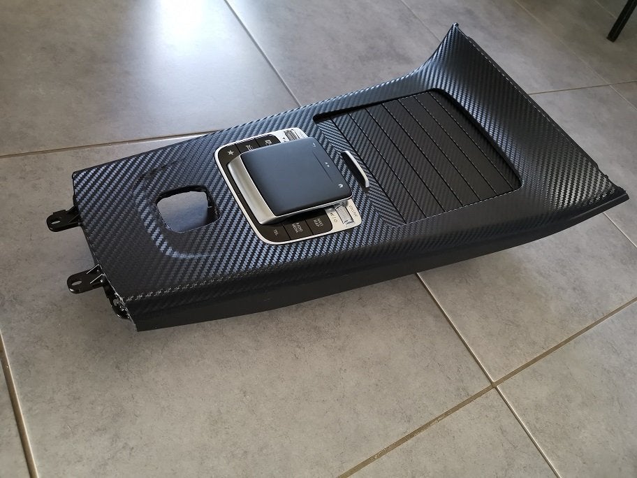

The wrapping was fairly straightforward although there are a lot more curves in the console than I had realised.

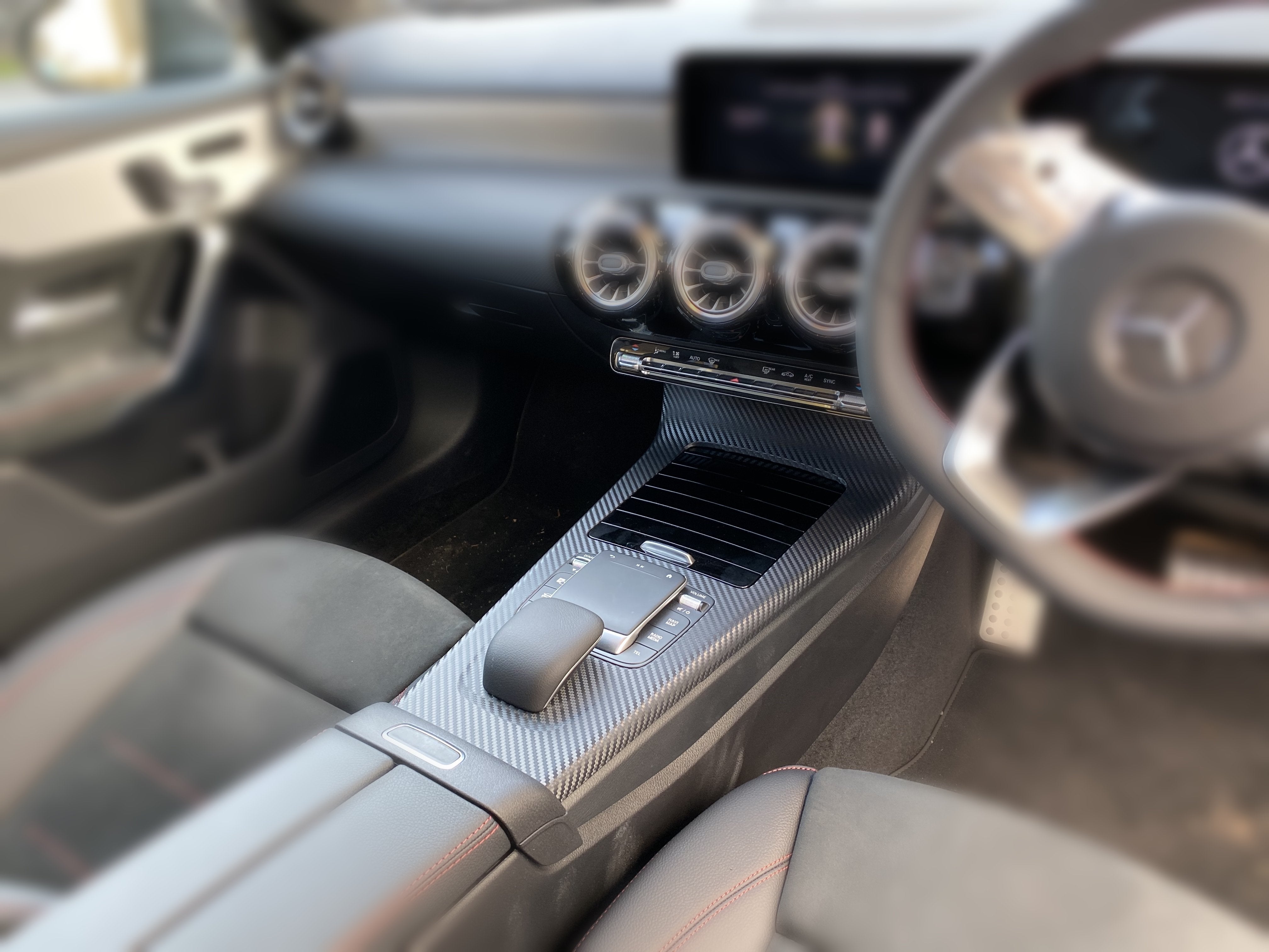

Still, I’m well pleased with the overall result:
Much better than the original I think.
Many thanks Raymondooo for giving me the confidence to do it
