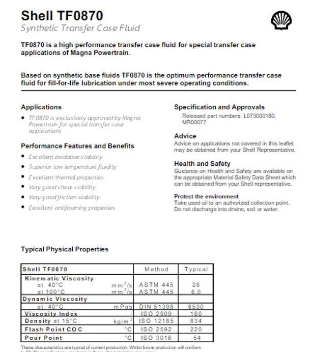

Then, the unique, (as far as I can tell) to our vehicles, the side clutch pack oil; MB reference 235.64.
According to Magna, this IS different to the VAG spec.
Both the oils apparently are only made by SHELL.
I cannot swear to this, given the number of specialty lubricant manufacturers in the world.
However, if we are talking a true muti national lubricant distribution system, so everyone here can use the info, I think SHELL is it.
Shades of the Spark Plug fiasco.
The VAG product supposedly uses SHELL's TF 0870
Our vehicles use SHELL's TF 0870 B
The difference apparently all being in the B.
Now, I am not saying your local SHELL distributor will have it on the shelf; however, they SHOULD be able to order it in for any of you.

As for Shell TF 0870 B, that meets 235.64
