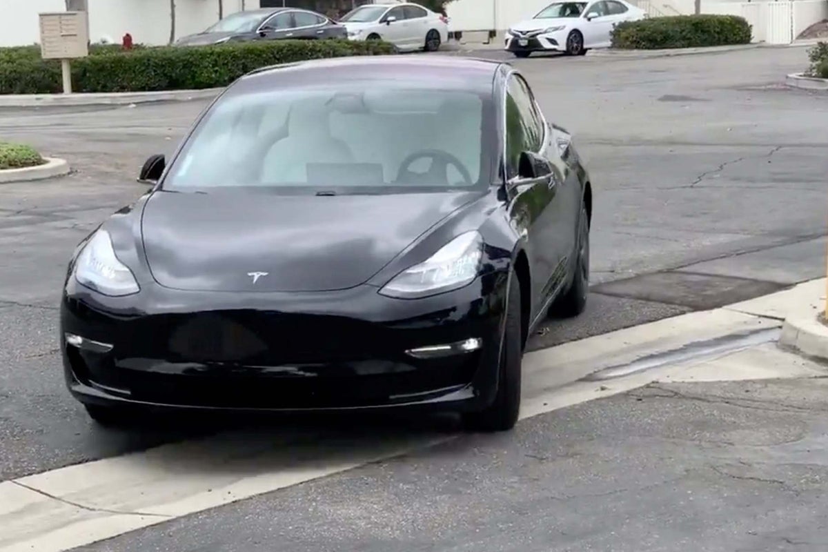

The family of a doctor who died after allegedly becoming locked in his Tesla that caught fire after a crash is suing the carmaker.
