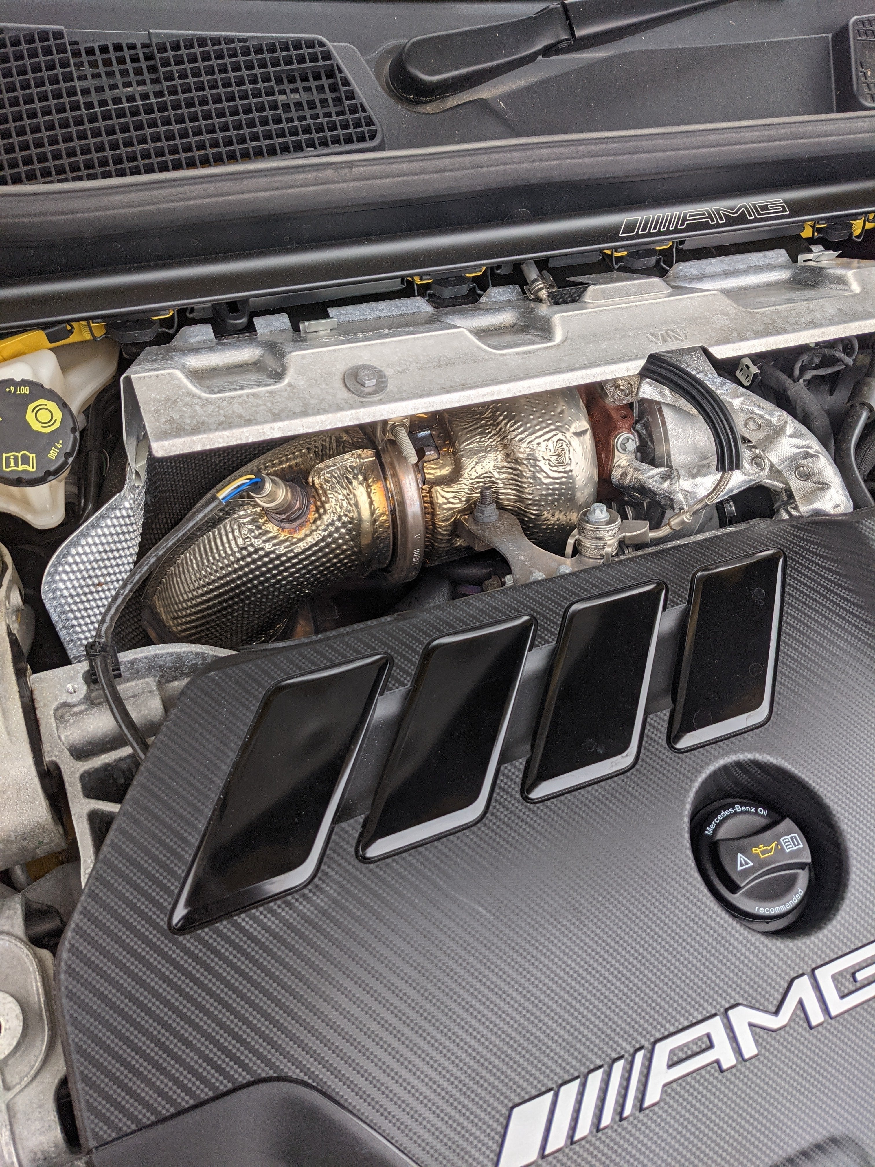

You'll first need to determine whether your car's downpipe is running on a pair of sensors or 2 pair of sensors. The easiest way is to look at the engine bay and see whether you can see there 1 sensor or 2 sensors at the downpipe.
If it has 2 sensors, then the Miltek downpipe will not be suitable for your car. If it has one, you can use it.
Secondly, you will need to determine whether your car is the GPF or non-GPF version. If it is GPF, you'll need a ECU remap to go with it or else the car will have a check light and the power will be restricted as a safety measure by the ECU.
As far as I know, UK models are fitted with GPF.
I've attached 2 pictures below, one with only 1 sensor attached and the other is with 2 sensors on the downpipe so you can get a visual idea of what I'm talking about.

Hi guys, in new to this forum,
I have been reading through this thread as it is something I am looking into doing but I am also from the UK and I only have got one sensor on my downpipe and there was people from UK saying they have got the 2 sensors ? Would someone be able to tell me the as to why I might just have the one sensor? ( Attached photo )
Thanks in advance
