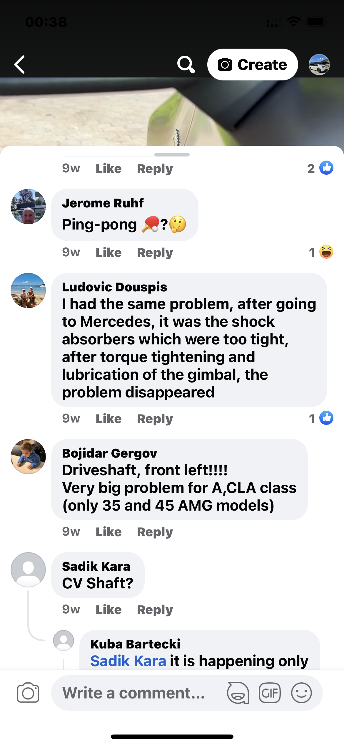

Been experiencing this recently and i'm not sure if its because it's getting colder or something to do with my car. When I start my engine in the morning, I usually do a 3 point turn to get out of my driveway. When locking my wheel or turning the steering wheel so its near locked, and I drive, there is a weird sound from the wheels like loud clunking or the wheels clipping against something? Anyone experience this or something similar?
It is not Ackerman, it happens to only when I turn left, and some people from the group said it might be a driveshaft issue.

lol it happens everyday since day 1, but it gets much louder than before. My car is around 21k km, the steering also becomes extremely loose once speed hits above 160km/h.

Lol just sent my car in for the repair yesterday. They can duplicate the issue but can’t find the cause of it, and the service manager even wanted me to pay for the diagnostic fee (telling me dirt and small rocks were the reason, totally bs) Definitely I refused to pay for anything while my car is still under warranty. After I got home, noise is reduced but it’s still there. Similar situation happened on my bro’s CLA45 too while his car was also under warranty, shame on mb dealers in Vancouver area.
