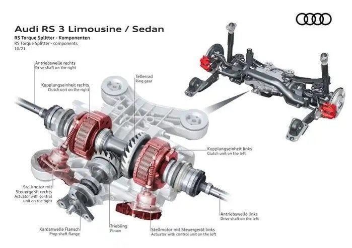

To serve as a reference, the Magna unit in the RS3 and Golf R appear to be identical, down to the case design, internals, control units and mounting points:
The Magna unit for MB seems to have been put together slightly differently (I'm assuming for packaging considerations) with the most obvious being a different case design, different mounting points, and the passenger-side control unit is clocked differently.
So whether or not they all use the same oils for the gear sets and clutch packs, I don't know (but I strongly suspect the internals are nearly the same, if not identical). One additional thought: even if the internals are identical, different programming of the units by Audi, VW & MB to illicit different behaviors may very well necessitate different operating fluids.

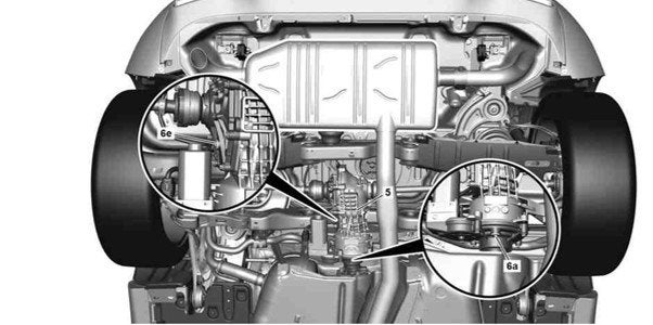

While I can't fully answer your question (manufacturer, model number, etc.), WIS lists two rear differentials for the 118 and 177: the base differential "except models xxx.353/.354/.653/.654" (i.e. -45 & -45s), and the TWIN torque vectoring rear "models xxx.353/.354/.653/.654." Below is a picture from WIS of the base differential showing one drain and one fill plug:
So it would appear as the -35 shares the same rear differential as the base -250. For reference, the changing procedure calls for 0.6L fill capacity, renewing the drain and fill plugs, and torqueing both to 35 nm.
Forrester,
