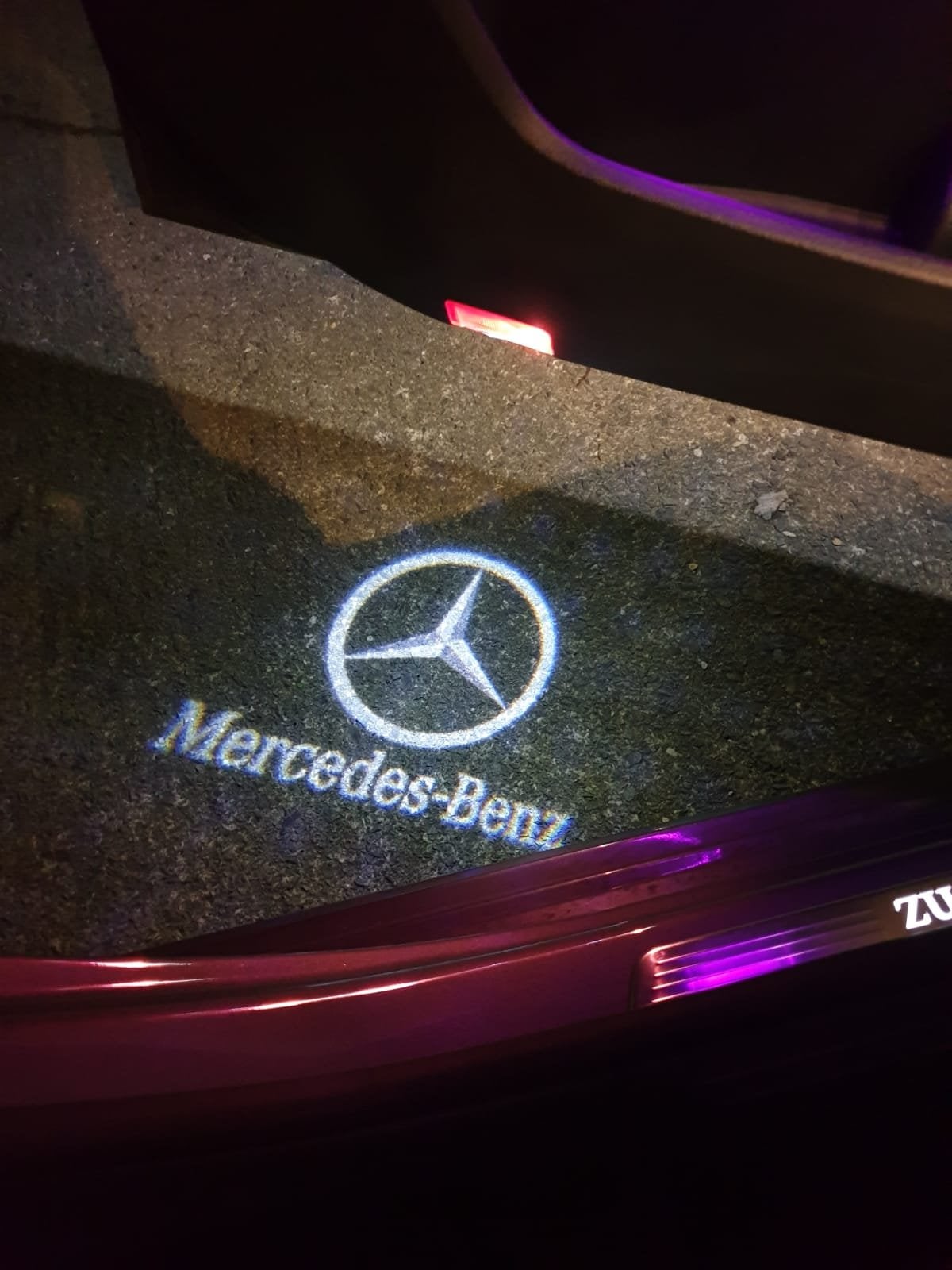

For reference, mine are aftermarket ones, they're fairly bright but not visible at all during the day.
